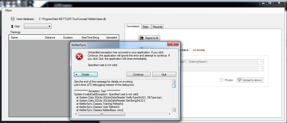

I'm having a problem starting your application. I would like to export training data from my Kettler World Tour 1.1.7 to TrainingPeaks web site. Error pic included ...
Thanks, Roman

Maybe there is a difference in db files between kwt 1 and 2, I can take a look if you share your KelterUsers.db
Hi!
This is my KettlerUsers.db file (kwt 1.1.7.).
Thanks, Roman
