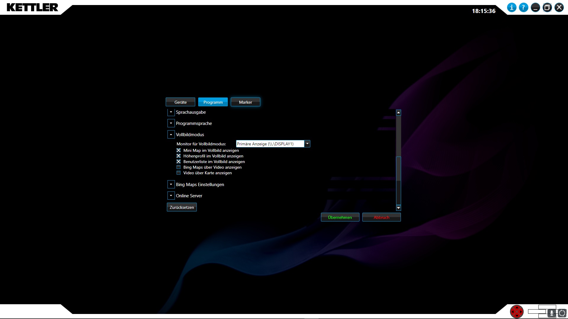

If this doesn't work and your RLV window is too small -> you have to logout in KWT -> settings -> full-screen settings ->Point 1 to 4 from top have to be crossed on. Uncross 5 and 6.
See jpg down.
