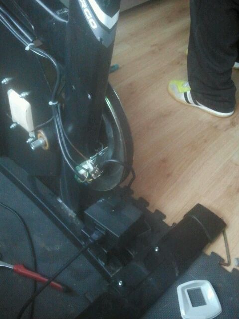

I have dissasembled the ergorace
A question for the people who can help:
The electrical transformer has a green light, this light should be permanently ON or should be alternating ON/OFF (intermittent)?
Can anybody answer this question?
Thanks in advance
The transformer should be always on when power switch is in position I.

Thanks Wolgang
But just to clarify, the GREEN light should be permanently ON if the transformer is working correctly? (with the bike switch on)
I think so because my transformer does and I have only transformer and display. (Test device without real brake and ergometer but same transformer.
Even when you switch it off the led will be on for some seconds because the transformer has some capacity.
I think your transformer is defect.

Thanks again,
the light of my transformer is:
- When the bike is switch ON, the green light is ON and OFF
- When I switch THE BIKE off, the green light stays some seconds ON and OFF (intermittent) before turning OFF
I NEVER see the GREEN LIGHT CONSTANTLY ON
Can be a problem of the transformer?
Yes I think so.
